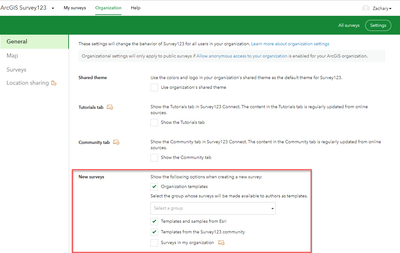

If you or someone who is an administrator in your ArcGIS organization logs into the Survey123 website and navigates to Organization > Settings > General is "Templates and samples from Esri" or "Templates from the Survey123 community" enabled under the "New surveys" section?
If you are in ArcGIS Enterprise and are using the Survey123 local website installer you may need to go through the Configure an installed ArcGIS Survey123 website in disconnected environments workflow to have access to the samples and templates.

ZacharySutherby
Hello @DanielLoegelCMS

DanielLoegelCMS
Zach,
That did the trick, got the AGOL admin to make the change and I now have access.
Much appreciated!!
