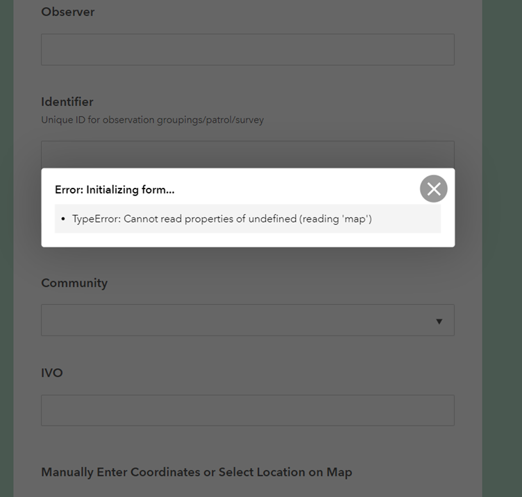

Hi, I have a strange error occurring on the survey123 Web APP.
  • I published a survey123 form from survey123 connect with an external choice list (select_one_from_file list.csv).
  • When I open the form on the Web App I receive the following error "TypeError: Cannot read properties of undefined (reading 'map')" and the geopoint map will not load.
The form functions perfectly without an error in the field App
I have tried publishing the survey with the choice list in the media file and I get the same error.
If I publish the survey without linking the lists I do not get the error (but then obviously the select_one lists are not populated). It seems to only occur in the Web App and after I link an external choice list.
I am using version 3.17.54
Any help with this would be great.
