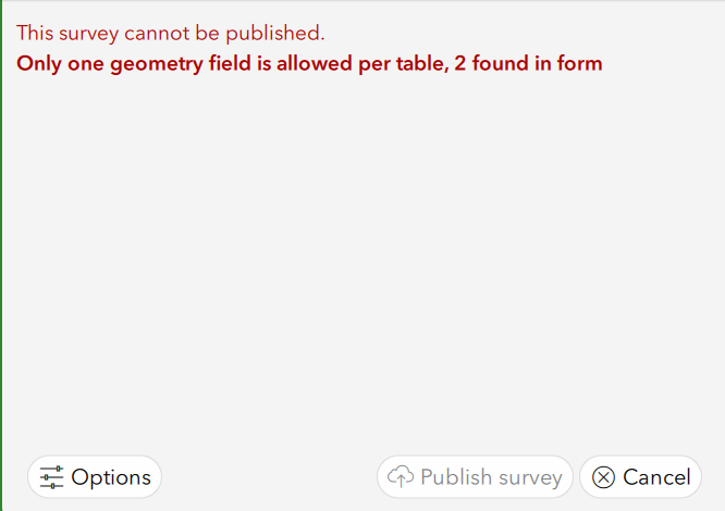

RogerAsbury
When attempting this solution, I get the attached error.
Roger Asbury
Analyst/Programmer - Fairbanks North Star Borough
JenniferAcunto
You can only have a single geography question that is recording data. All of the maps that we are pulling calculations from need to have the bind::esri:fieldType set to null.
- Jen
RogerAsbury
Awesome. As soon as I added the nulls to the proper field everything fell into place and started to work. 🙂 Thanks very much for your help!
