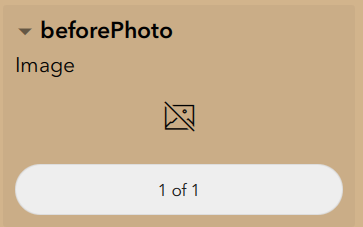

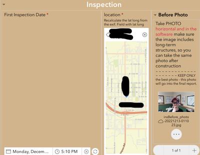

In the original app, I can see the photo from inspection 1 in the inbox, BUT it doesn't work in the 2nd app that's linked to the hosted service. Is there some magic I can do to get this to work in app 2?
MichelleWilliamsERM_0-1670948284984.png App 1 opened finish inspection from the inbox.
MichelleWilliamsERM_1-1670948451301.png App 2 opened from the inbox.

Sorry about not adding the file, below is a screenshot of the survey that's linked to the hosted service. If you need to see more, I can private message you.
The before photo is the image that won't download into the inbox.
