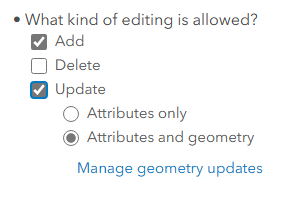

I also am getting this error when I try to print out a map. The layer was created by Survey123. It is trying to execute an end point (query) that does not exist. The layer actually has a different feature server with a query operation for the view the web map uses but for some reason it is referencing a the feature layer feature server which has no query operation.
What it references (no query - Feature Layer😞
...services/service_1e..GUID..9b/FeatureServer/6
What I wish it referenced (has query - View - is what is in the web map specified in the web map):
...services/survey123_2a..GUID..e7_results/FeatureServer/6
To enable query on the feature layer it's trying to call you have to:
Enable 'Update' or 'Delete'.
Re: Capability 'Query' is not set on the layer. - Esri Community
Once I did this I was off to the races - thanks @MJBiazar
