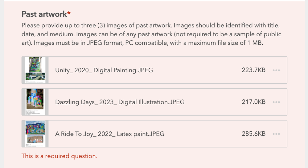

YasMehrsa
Hello, I am having a similar issue but in the image uploading section of a survey.
Although I am uploading my files and they are following the requirements I still get the error of "This is a required question"!!!!
.....any thoughts?
