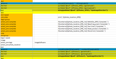

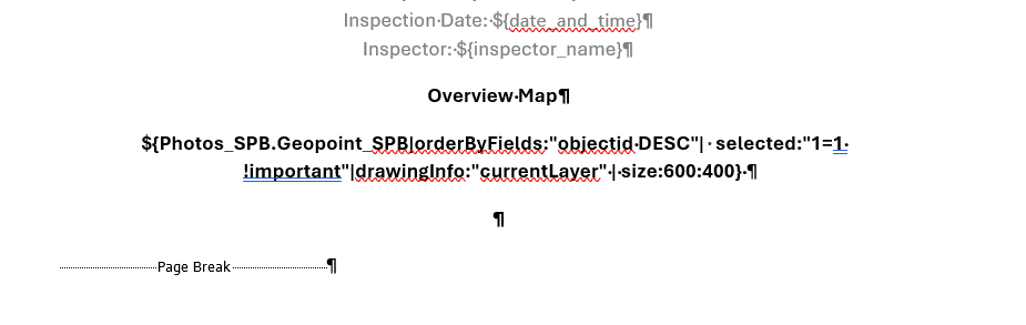

This is my first time trying something like this in the 'summary section'. I need all locations, which have been selected out in the survey 123 website to show up on this map. I thought I got it to work but it doesn't seem to be working as I needed it to. Now I have changed my methods. I have attached a screenshot of what I currently have in the syntax.
Thank you in advance!
AudraPayne1
The feature service published has an inspection main component then a repeat 'Photos_SPB' which you can see I am calling out in my firs screenshot then a second repeat 'Photos' that you can see I am calling out in my second. My need here was to call out whatever inspection and repeat that was selected on my arcgis survey123 webpage in the data ribbon. I needed this map to show all the features I have selected. these codes have achieved this. I hope this helps others. Answered my own question after two weeks here are the results. When you have repeats you cannot have a summary section encompassing these repeats. I actually haven't found a solution similar to mine I just tried a bunch of syntaxes until I could make it work.

I have two repeats though. 'Photos_SPB' and 'Photos' the latter one is my second repeat in this feature service. I have been able to map Photos_SPB work with this snytax listed below but it refuses to work for my second repeat. I have noticed several things do not allow me to use the same exact syntax for my second repeat in my survey which is very interesting.
Working syntax for repeat 'Photos_SPB'
${Photos_SPB.Geopoint_SPB|orderByFields:"objectid DESC"| selected:"1=1 !important"|drawingInfo:"currentLayer"| mapScale:100000 | size:600:400}
Not working on my second repeat 'Photos'
${Photos.Geopoint1|orderByFields:"objectid DESC"| selected:"1=1 !important"|drawingInfo:"currentLayer"| mapScale:100000 | size:600:400}
Other instances of where the second repeat would not allow the same syntax to be used, this specific example is in the CSV.
geopoint concat syntax wouldn't let me use it twice I had to create the second one. I have fixed this issue just pointing out that survey 123 might not like two repeats and so I might have to try and use a different syntax.
Sorry I am not the best at explaining everything on paper like this. the summary section does not work with repeat geopoint questions, so it had to be created as such shown in the example above, but I just find it very interesting how it's throwing me an error of a black map for my 'Photos' repeat when the other one worked out fine.
AudraPayne1
Update, once i removed the orderByFields:"objectid DESC" it began working for my 'Photos' repeat
