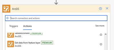

Your best bet looks to be the ArcGIS step and Get data from feature layer:
You may need to involve something like FME to get the functionality you are looking for, but I'd at least look into this first.
