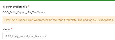

Survey123 | Feature Report | Maybe Bug | When I remove the if statement I get a tag ${/} is unopen

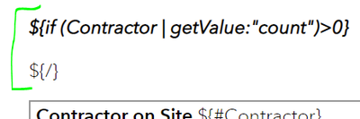

I want to remove the If statement, which is outside my repeat. When I do I get the error below. Please advise!
${if (Contractor | getValue:"count")>0}
Contractor on Site ${#Contractor}
Contractor Name: ${ContractorName}
Contractor Supervisor/Representative: ${ContractorSupervisor}
Number of Contractor Personnel Onsite: ${NumberofContractorPersonnel}
Hours Onsite per day: ${ContractorHoursonSite}
Permits Completed ${#PermitSystemRepeat}
Type of Permit ${PermitSystem}
Description of other permits ${PermitSystemOther}
${#PermitSystemPhotoRepeat}
${#PermitSystemPhoto | size:300:0:0:300}
Complete JHA/JSA for each task: ${#JHA_JSACompletePhotoLog}
${#JHA_JSACompletePhoto | size:300:0:0:300}

May seem obvious, but are you removing both of these lines when you delete the if-statement? The ${/} below the if-statement doesn't appear to be paired with anything.

Thank you, thank you, thank you!
I'd been looking at this all morning, and it didn't break until I removed the if statement, so I thought that was the problem. I need some coffee!
