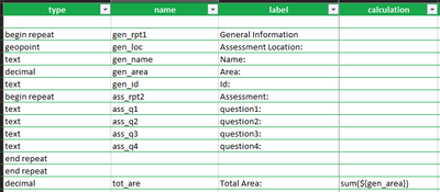

I'm probably missing something, but why not use a nested repeat?
E.g.,
The general information is within the first (parent) repeat, and the dynamic information is within the second (nested) repeat. This is typically how you'd collect data with common fields, and allows for very easy transformation. However, like I previously mentioned, I may be missing something in the workflow here.

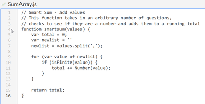

FYI, Managed a solution within js.
  1. Create a list of all area values from repeat (using join())
  2. Create a unique list of area values from repeat (using unique.js)
  3. Convert string to array (using SumArray.js)
unique.js (adapted from https://community.esri.com/t5/arcgis-survey123-questions/challenge-question-looking-for-a-way-to-dis...)
SumArray.js

abureaux
MVP Frequent Contributor
Is this all within a single survey? If so, "area" should be in a parent table, and your "point data" in a nested repeat. That way the "area" is only collected once per location.

abureaux
E.g.,
MarkWILSON_LLS
@abureaux , thankyou, I think this is the most logical process to follow.
I was really hopeful for a .js sum unique array  or something similar but I totally get the simplicity in the structure of the nested repeats.
I really appreciate your feedback.

MarkWILSON_LLS
SumArray.js
