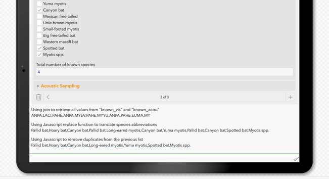

I attached the XLS form, and here are the Javascript functions I embedded in the survey.

This might be a helpful references for you:
https://community.esri.com/t5/arcgis-survey123-blog/extending-survey123-smart-forms-with-custom-js/b...
Also, I didn't do this in my XLS form because I was just testing, but remember to set the bind::esri:fieldType to Null for all of these Javascript and display fields if you don't want these fields to be part of your feature layer attribute table. Also, the fields that are used in the calculations can have "hidden" set as the appearance type so they won't display in the survey.
I really hope this helps! And if anyone else comes across this and has pointers, I'm all ears. I came up with this solution as a complete newbie to Javascript (~intermediate familiarity with Python) and referenced StackOverflow a lot...

So, I had a bit of fun with this "challenge question" and wanted to find a solution, as I am very new to Javascript and wanted to take the opportunity to practice, while also hopefully help someone out.
I got a solution to work 🙂  It's almost embarrassing to share since I *know* there are better methods out there and I'm probably not doing it in the most efficient or logical way, but....it works.
If you're still needing a solution and want more details, let me know and I'm happy to share the XLS form.

mrosekulick
I just tried it, and it works like a charm! Thanks again! 🙂
