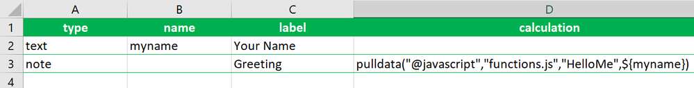

Let's start with a simple scenario. In Survey123 Connect, create a new survey and add a couple of questions as shown below. Our goal is to create a custom JavaScript function to calculate the greeting question.
Using regular XLSForm syntax, we could calculate the greeting as follows:
concat("Hello ", ${myname})
This already teaches us something: custom JavaScript functions are not always the best approach. If you can solve something easily using pure XLSForm functions, do not use a custom JavaScript function. In our case, we will use this example only because it helps us focus on the basics of setting up a custom JavaScript function.
To invoke a JavaScript function from XLSForm, we use the puldata() function. For example:
pulldata("@javascript","myFunctions.js","HelloMe",${myname})

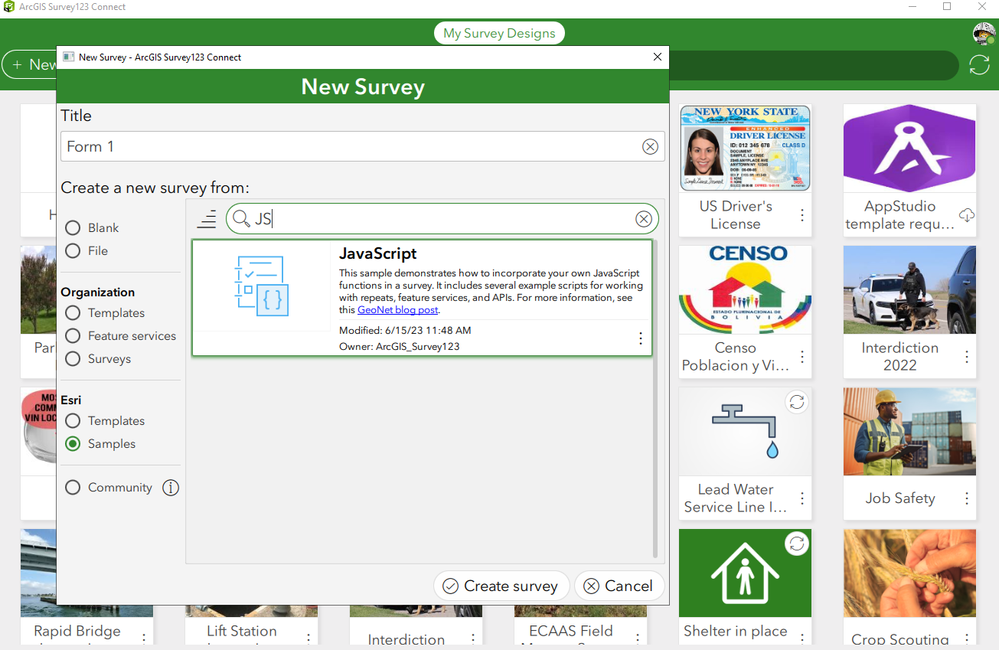

Survey123 Connect includes a new XLSForm sample illustrating how to use custom JavaScript functions in multiple scenarios. As you get hands-on, this is a sample worth checking.
