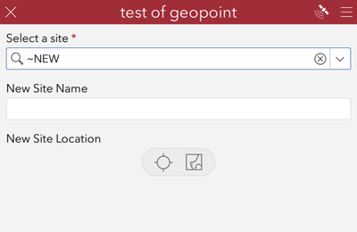

I created a survey through Connect. I added a filter (${site_list="~NEW"} such that the geopoint question is only visible when a new location is being entered. However, the 'map' interface isn't visible in the survey. One must click on the AmyAlford_0-1733253567739.pngicon to render the map in a new window. I tried several iterations to see where the issue is coming from and it appears to be only when there is a relevant filter set. I've attached an example xlsform. I'm using v3.19.

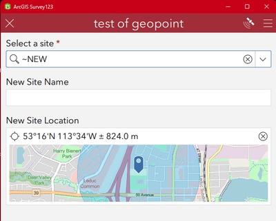

That said, when I swap to body::esri:visible, I get this
As compared to relevant (again, this is what I would expect from a geopoint shown by a relevant statement):

Here is the file I'm using for get that behaviour (attached).
Note that I am using the most recent versions of the Field app and Connect. Using older versions may have a different result. If you install Connect and Field App through the Microsoft Store, they will be auto-updated.
