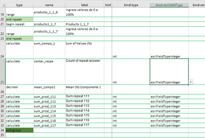

I'm attaching the XLSForm

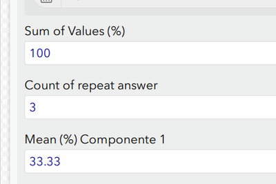

In the sample I posted I filled out 3 of 7 fields and the count seemed to work.  That is why I asked what the exact issue is.  Range questions start as blank not 0.  Count ignores blank automatically so it all just works.

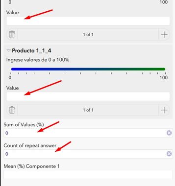

I uploaded the XLSForm you send and works fine; however, if I want to hide these calculations from the form e.i. Value, Sum of Values, Count of Repeat (see image below, red arrow) the calculation goes to **bleep**.
I try with "hidden" and "calculations" in the type column and also in the bind::esri:fieldType
column I selected "esriFieldTypeInteger". But no luck, I don't why this is happening?
Image 1:

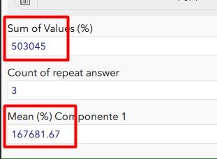

Image 2: when I use calculate in type column in row 8

DougBrowning
MVP Esteemed Contributor
I set both bind and esri bind and it works.
Bind is for within the form and esri bind is the data storage so you often need both.  Hope that helps.
Jim-Moore
In addition to Doug's solution, note that you can apply the 'hidden' appearance to any question type. For example, for Sum of Values, you could use the 'integer' question type and apply the hidden appearance. The question will work like a regular integer question, just not shown on the form. When using the 'hidden' appearance, there is no need to set the bind::type or bind::esri:fieldType as these are inherited from the question type.
For the 'calculate' and 'hidden' question types the field/bind type is string by default, so Doug's solution is the way to go when using these.
