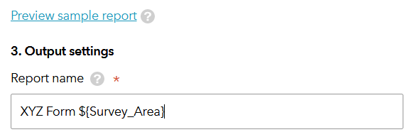

JennyHuang3
Thank you Jody!
Much appreciated to have this implemented! However, I do have a couple comments:
1. I was unable to preview the sample reports with the dynamic field name in the report title. The example below returns a zip file containing 2 records with file names XYZ Form_OID_Sample.pdf. This only worked when I consume the credits and generate the actual word doc reports.
2. Is it possible to set a default report name so that one does not have to remember the field syntax (i.e. ${Survey_Area} in above example).
Thanks again,
Jenny
