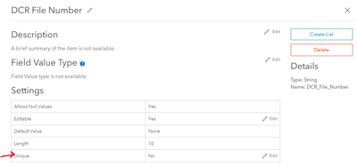

I am hoping to add some functionality into my XLSForm that would prevent data entry if a duplicate Project ID is entered into Survey123. I would like this to happen as soon as the user enters a Project ID into the form as the form is quite long (it would really stink to get to the end and then see this error!).
I feel like a JavaScript function would be the best method for doing this, however I am struggling to find an example and really do not know how to write one myself.
I do not think pulldata() would be a reasonable solution for this as it would be extremely cumbersome to maintain the external CSV - new projects are being entered weekly. The ideal solution would be a way to look back at the hosted feature service, check the field and see if the Project ID already exists.
I am also wondering if the "Unique" setting could be used to accomplish this; I suspect that it would not cause error until going to submit the survey form.
