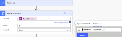

  • In your Flow, add a "Subtract from time" action with Interval: 1 and Time Unit Month and the expression:
formatDateTime(utcNow())
This step will grab the exact date 1 month ago - used as reference.
Outputs: "body""2023-06-12T04:30:10.5467055Z"

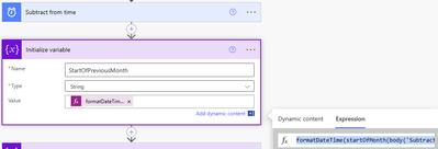

  • Add another step to initialize variable. Name: StartOfPreviousMonth , Type: String , Value expression:
formatDateTime(startOfMonth(body('Subtract_from_time')), 'yyyy-MM-dd')
This step uses the earlier reference and determines first day of that month.
Value is 2023-06-01

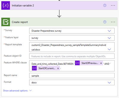

  • Next, the Feature WHERE clause is set up to reference previously initialized variables:

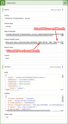

Date_and_time_collected_Data BETWEEN '@{variables('StartOfPreviousMonth')}' AND '@{variables('StartOfCurrentMonth')}'​
:warning:Ensure single quotation characters are placed around dates and spaces exist between SQL keywords.
  • Running the flow succeeds and you can observe how Feature WHERE clause gets formatted using the computed values.
