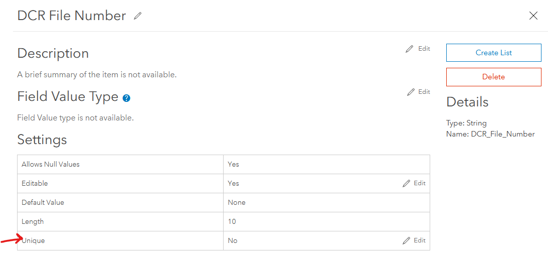

I am also wondering if the "Unique" setting could be used to accomplish this; I suspect that it would not cause error until going to submit the survey form.

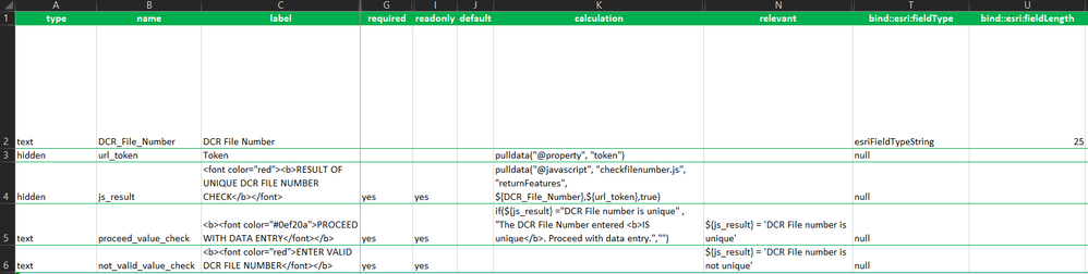

Next, I configured the XLSForm - here is what all of the populated columns look like (I hid all of the empty/non-relevant columns to fit this into one image):

Because of line 6 in the XLSForm, they are prevented from submitting their form until they correct the DCR File Number so that it is unique.
