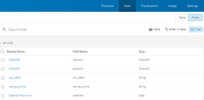

2. Go to the feature layer's page in  your ArcGIS Online and click the "Data" tab
3. Select the appropriate layer that contains your list

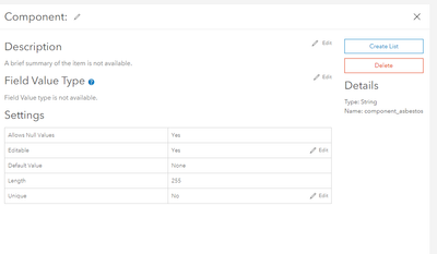

4. Click the "Fields" button in the top right and select your field that needs it's list updated

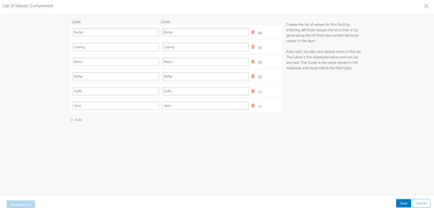

5. If you already have a list of values here, edit it and add your new options.  If you don't already have a list here, click "Create List".
(FYI - I think the "Generate List" option in the bottom left is a new feature. That might be worth playing around with if you have too many rows to practically add by hand)
List options that were present when you first published your survey should look correct here. Those that aren't will need to be entered as you have them in your S123 choices tab.  (I assume that 'Generate List' will populate your new options, code values only, if you have features present in the feature layer with those new options stored.)
