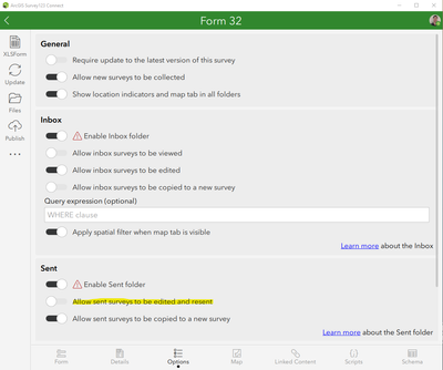

Hi @ryanEvanczyk,
With the latest Survey123 Connect (version 3.12) it is possible to enable the Sent folder, however disable sent surveys from being edited. This would allow sent surveys to be viewed, or copied to a new survey, and you can even adjust those options also. Refer to below options tab in Connect:

When you mention that I can adjust the sent folder options beyond 'edit/resend' and/or 'copy to a new survey', how do I do that?

Hi @ryanEvanczyk,
If you are using the latest release of Connect, version 3.12, you will see the options to configure the Sent folder and other folders in Connect in the Options tab for the survey you are authoring. See my screenshot previously posted above.
