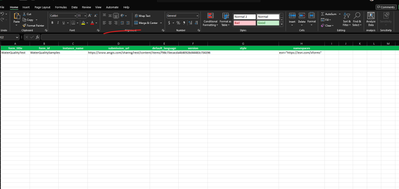

Would you be able to provide a screen capture of the submission_url set in the XLSForm? When you say you set the submission_url to the "Feature Class address that is located on the feature service overview tab" it sounds like you set it to the URL for the Item Details page (https://<org>.maps.arcgis.com/home/item.html?id=<itemID>) which would be the incorrect URL, the submission_url should be the content root endpoint (https://www.arcgis.com/sharing/rest/content/items/<itemID>).

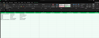

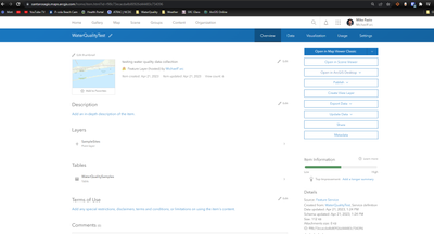

Thank you for your reply, I have tried multiple different addresses, including the default that is provided when creating the form. I have removed the repeats, and really dumbed down the data to just try and get a proof of concept working. Here are a couple of screenshots showing my current settings:
