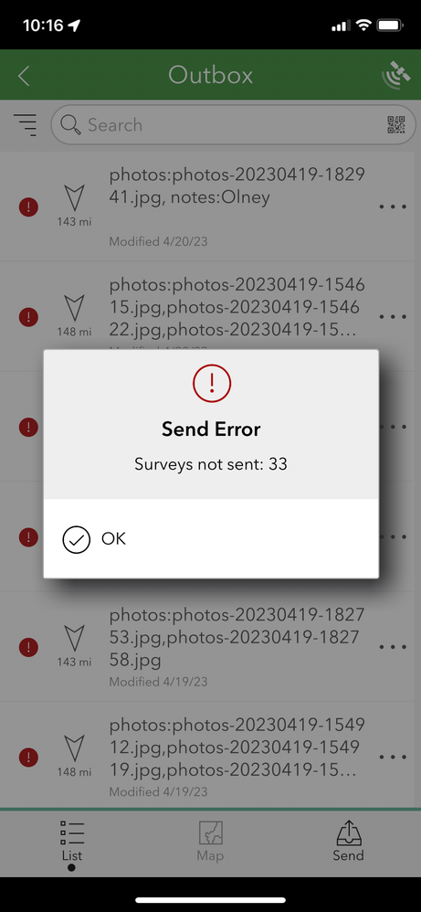

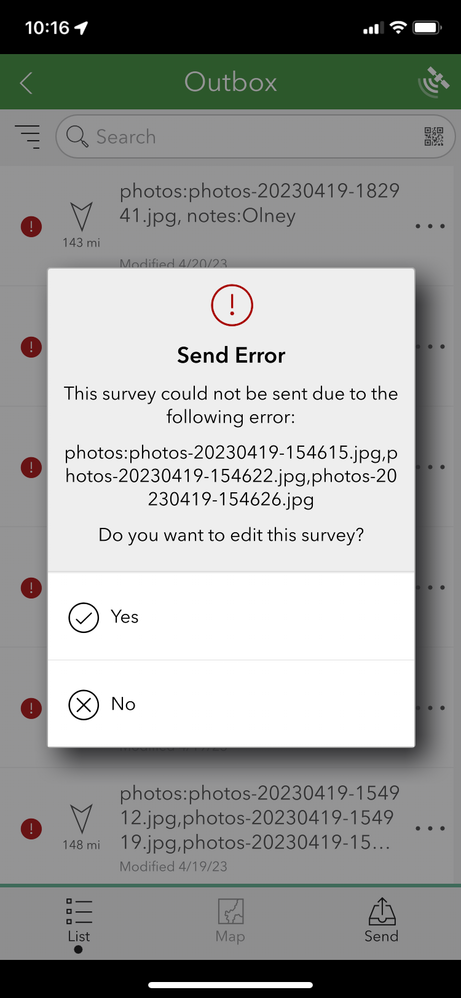

Here are the screenshots from the user who is not able to send his submissions from his device.MicrosoftTeams-image.pngMicrosoftTeams-image (1).png
