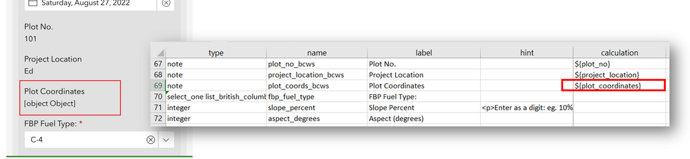

@Marie-AngeFournier-Beck  No bad for your first survey! The problem is in question "plot_coords_bcws".  Have a look at the screenshot below: Your calculation is copying the value of a geopoint straight into a note question. When the data is submitted, ArcGIS rejects the record because a geopoint object cannot be stored in a text field.  The error Survey123 gets back from ArcGIS is not very informative, but that is what is going on.

  • Technically, you are not required to set a value to the name column for a note. In fact, you rarely want to do that. See details in this blog.  If you leave the name column empty for your plot_coords_bcws question, your form will submit correctly. You may want to do that for the two prior questions as well.
  • Now, if you really want to display the coordinates as text, I suggest you change the calculation to string(${plot_coordinates})
