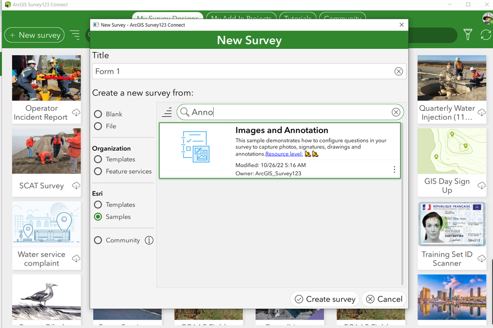

If you load your 300 images into the media folder, you will be able to reference them and dynamically set the annotate question.
Check the sample in Survey123 Connect for details.
