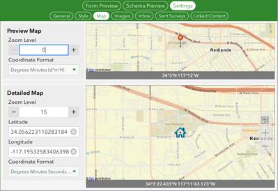

(additional issue is that my map continues to load from Redlands, CA vs the set extent. any tip on this would also be appreciated!)

Here is the setting to change the default map location
