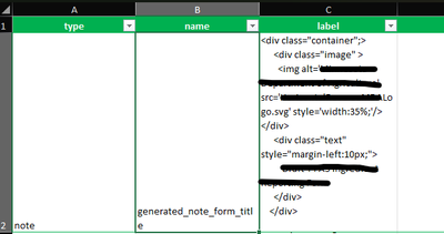

Here a sample of adding an image to a title using html.  This stacks it with image on top and title underneath and left justify.  Adjust as needed,
<div class="container";>
      <div class="image" >
        <img alt='Alt Text Here' src='Logo.svg' style='width:35%;'/>
</div>
      <div class="text" style="margin-left:10px;">
          Form Title
      </div>
    </div>
note that this doesn't work well for field app, but looks nice in the web app.
Neal_t_k
I have this implemented as the form title and in the web app it appears as the header on every page, using "generated_note_form_title" in the name field.
