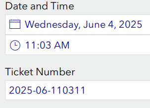

dsinha
Thank you so much @Neal_t_k. After having spent almost 3 days trying to calculate a ticket number using the method in the link, your suggestions are godsend.
I went with this format

@JordanHyche_MCI I used this in the calculation field for datetime so that it does not change to the most current date/time when opened/editedonce(now())
