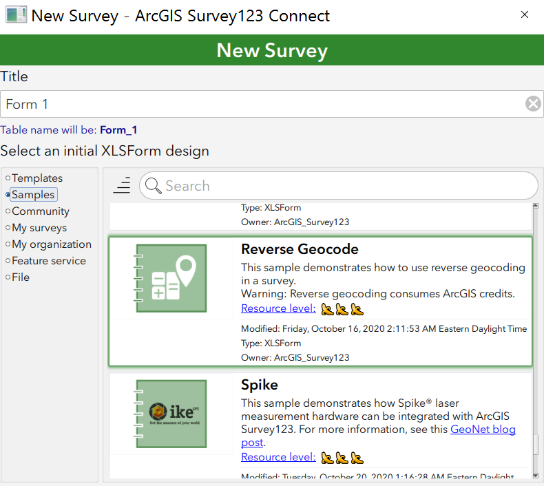

My reverse geocode within my form, that auto populated the nearest address, has stopped working.  I checked the sample reverse geocode form available within Survey123 Connect and I get the following error.
{"error":{"code":500,"message":"Error performing reverse geocode operation","details":[]}}
Any help would be greatly appreciated.
