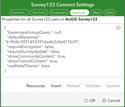

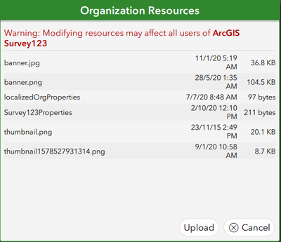

Hi @MARTAM_,
Can you please open Connect, sign in, go to the Settings menu, press and hold on the title (Survey123 Connect Settings) and you should see a new tab button appear called Organization. Can you take a screenshot of that page and also then click on the Resources button at the bottom, and take a screenshot of that page (it should look similar to the attached images).
