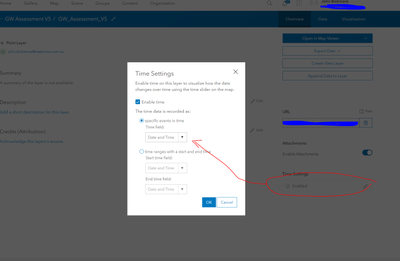

JohnBickmore
i have fixed the issue
I went into the item details page for the form and saw that time settings were enabled
I changed the time settings Time Field used from the start date to a date and time within the survey
My dashboard is working again.
