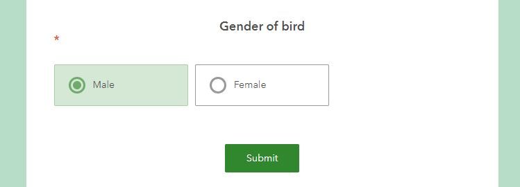

I'm having a strange issue, when a question is centered the red asterisk indicating a required question is moved to its own row below the question, rather than being located at the end of the question.
The same occurs on the Survey123 Connect fit on screen display, smartphone display etc.
Is this a bug? Are there any fixes available to this?
Additionally, is there a way to center the choices as well? (the male and female choice buttons)
With the example above it may seem strange to want the field and choices centered, but its a sample example only, with the original survey theres good reason for the field to be centered.
Thanks!

Hi,
Can you provide the XLS form?  Centering the questions is not the default behavior, so to help diagnose this it would be useful to see how you've formatted this to be centered.
Regarding the centering of questions, it isn't possible to center the questions with a horizontal appearance; if you form only has a few choices, the 'Likert' appearance may be an alternative that is centered within the form.

Hi James, I am unable to share the form itself but below is the row for the centered field
JulietK_1-1605815603512.pngJulietK_1-1605815603512.pngJulietK_0-1605815563236.pngJulietK_0-1605815563236.png
Ah thats a shame the choices cant be centered, I only have two choices for this field and the choices are unrelated, so the appearance of likert might be unsuitable. Thank you for your response!

Hi James,
Does the screenshot of the html formatting help diagnose the mislocation of the asterisk issue? Do you think this may be a bug that will be fixed, or should I abandon the use of <centered> altogether?
