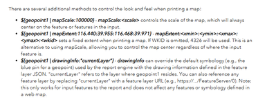

However, I'd like to set a minimum scale, so that no matter what, each map is at least 1:1000, for example. As it stands right now, a geopoint question matches the scale set or the extent of all features in the map.
How can I set a minimum scale for this?

Thanks for the response.
I've been experimenting with that, but if you set a scale that would be too zoomed in to see all of the features, it will zoom in past them. So, if you set the scale to like, 1:1000 and then you have points 30 miles apart...
What I've settled on is two maps: one that appears if there's more than one geo point and one that appears for one geopoint. I set a scale for the single geopoint map but not for the multiples.
I don't love this.
Honestly, I don't love any of the way the reports handle maps. For one thing, at a minimum let me print the scale the maps is set to. Impossible unless you manually set it, it seems.
