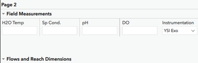

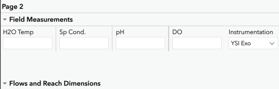

The problem I'm having is that my 'relevant' fields are taking up space in the UI even when they are not yet appeared.  For example: there is a large gap below my w5 which I would only like to exist when the instrumentation question is answered 'other.
See the large gap.

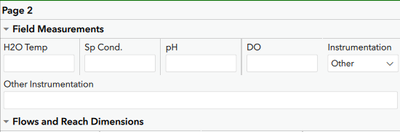

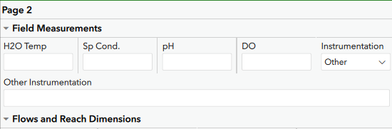

and it looks exactly as I would like it to when the relevant is TRUE.

Use dynamic-grid. Fixed-grid will hide the question and show a blank space. Dynamic means that questions and groups will move around on the form to make use of the screen.
