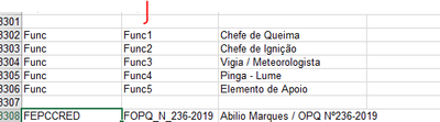

 hello good afternoon, I'm using code in the relevant column, in order to show the question I want, it's inside a repeating group, although in the other questions it's working, on this one it's not working
the probem line in xlsform = 58

The name column is what is actually stored so you need to use that in your check.   I suggest making the name and label columns the same.  Also I would not use the same name for the list and the field. Hope that helps
