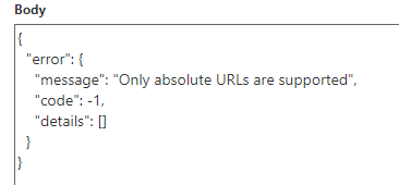

I have completed steps 1-6 and am getting stuck on step 7 where testing the connection gives me the following error on 1: GetOwnedSurveyList
ERROR:
Has anyone successfully created this custom connector between Power Automate and Enterprise via new App?

Hi, I have it working on two ArcGIS Enterprise' at this point. I can't remember errors like this. What happens if you just save it anyway, maybe a flow will bring another error. I know that we had issues with the enterprise not being trusted by our office 360. I needed to get IT to trust our Enterprise.
If every thing is filled out like in the link, I would try to run it anyway and see if there is an easier error to understand, but it seems that it don't like the URL. Sorry I can't see right now how my settings are, but can confirm that it is working.

Hey, Thank you both for the response. The error that was not allowing me to connect to the portal was two fold... 1. Wrong portal address was tacked onto the end of  Step 2. and secondly, our Certificate expired and had to be renewed.
I now have it up and running! Thanks again.
