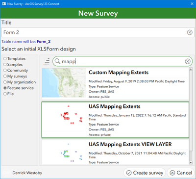

If that's the case, you need to use the option to create a new survey123 form from an existing feature layer (This is in Survey123 Connect....I haven't used the web designer in over 3 years so not sure what options existing there now)
In the example above, I'm using the "Feature Service" option to create a new survey from my "UAS Mapping Extents" feature layer.

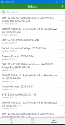

- Use the "inbox" in the Survey123 App to find an existing record and then open it for editing:

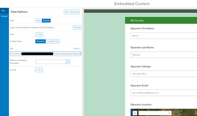

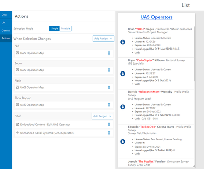

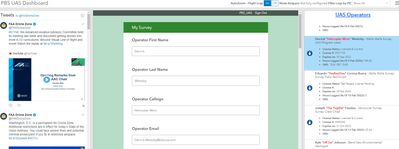

-Using Ops dashboard and a list element + embedded element (similar to the approach above)
Embedded content element set up to show the embedded survey123 web form, with URL parameters to access a specific record (objectID) in edit mode (This is an old setup. You'll need to use globalID now)
List element set up to filter the embedded content window to the objectID that's selected.
