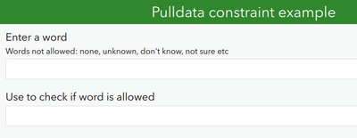

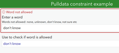

To make it easier to explain I just created a quick example, here are some screenshots:
I have not made the pulldata expression text field hidden, just for demo purposes, but in your final survey design, you can use hidden appearance or hidden question type, and set the esri field type to null if preferred.
