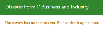

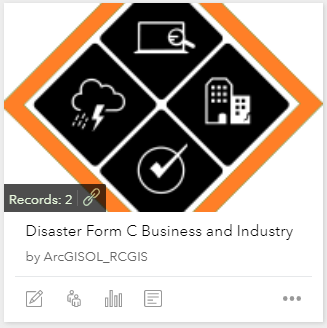

My survey123 data isn't showing up in the survey123 website under the data tab, but when I look at the feature service and the stakeholder view, the data is there.  The number of records even show up on the survey's thumbnail on the 'My Surveys' page.
But this is the message I see when I open the data tab.

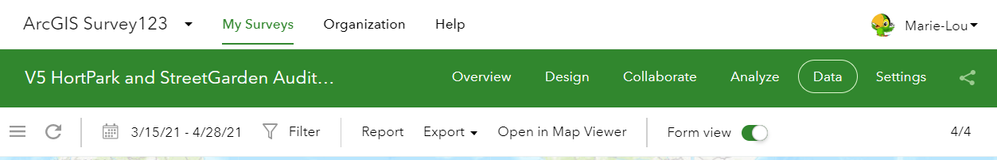

When I open the data tab for another survey, I notice that the top line looks different - The survey that doesn't open the Data doesn't have Options, Refresh Data, Report Tab or the Form View option
Survey where data doesn't openSurvey where data doesn't open
This is the top line of a survey that does open the data2021-04-28 10_13_38-V5 HortPark and StreetGarden Audit (AGOL) - Data.png
