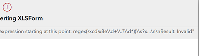

Hey, this is great, that explanation is so helpful! The only problem is that Survey123 Connect is giving me the below error:
ZachBodenner_3-1667830282009.pngZachBodenner_3-1667830282009.pngZachBodenner_4-1667830303459.pngZachBodenner_4-1667830303459.pngZachBodenner_5-1667830322471.pngZachBodenner_5-1667830322471.png
Here's the xls form with the regex in the constraint column:
Happy mapping,
- Zach
ZachBodenner
MVP Regular Contributor
Update: it worked when I structured it this way:
regex(., '^(\d+\.?\d*)(\s?x\s?)(\d+\.?\d*)(\s?x\s?)(\d+\.?\d*)')
I used the email regex formatting as reference and added (.,'^ to the beggining.
