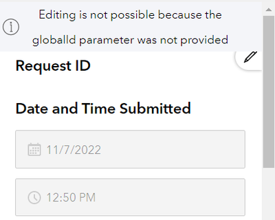

Bryan_Wade
Ismael,
Thank you, that worked. Now i am getting a GlobalID error message when I embed my review surveys into experience builder.
The GlobalID is set to true for editing in the feature service.
