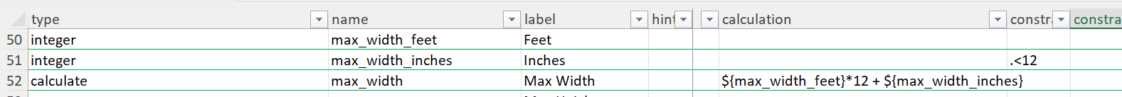

I have a scenario where I allow the user to enter a dimension in feet (max_width_feet) and inches (max_width_inches). I then combine these into a single inches value (max_width) and store that in the feature layer. This is working fine.

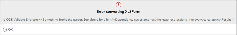

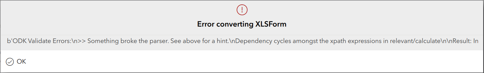

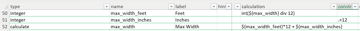

What I can't figure out is how to populate the feet and inches fields from the max_width field when the user edits a previously submitted survey. If I try and reference max_width in the calculation parameter of max_width_feet and max_width_inches I get the following error:
It makes sense to me that a field can't reference a field that references the first field but what is the right way to do this? Is it something to do with calculation mode? Or am I not using default and calculation correctly?

Basically, you can't extract data from your combined field and dump it back into the source fields with native functionality because it creates a circular reference. A field can't be its own source because it would endlessly cycle. You may be able to make a script that does that for you without producing a visible error. But it would still be a circular reference and unlikely to behave correctly. Just allowing those two fields to store data resolves all these issues.
