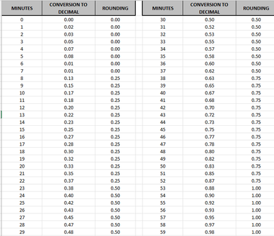

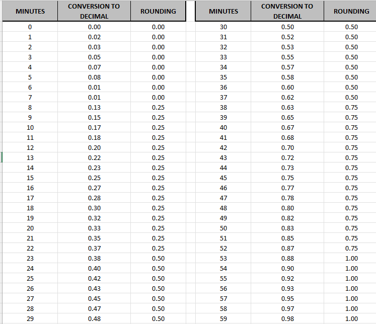

I am working on a complex form that I need assistance with. Trying to figure out if this is possible in Survey123 Connect or if I need to research how to do it in Power Automate.
Job Start Time: 8/26/2024 @ 12:25 PM
Leave Job Site: 8/26/2024 @ 4:43 PM
Here is what needs to be done. I've been given a specific rounding table that I need to, somehow, configure into the code:
Job Start Time turns into 13.50 (12:25 pm --> 12.40 --> 12.50)
Leave Job Site turns into 16.75 (4:43 pm --> 16.72 --> 16.75)
From here, need to be able to calculate the difference (16.75 - 12.50 = 4.25 hours worked). ALL ending calculated time on site needs to be 0.00, 0.25, 0.50 or 0.75.
