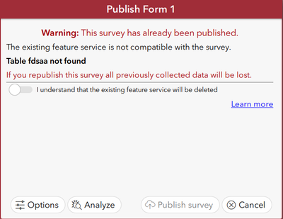

If you make large changes, the sharing permissions get reset. Have you checked those yet?
EDIT: By "large changes", I mean anything that results in this dialogue appearing:
Also, even if the sharing permissions look proper, just hit save again. Sometimes it helps.
