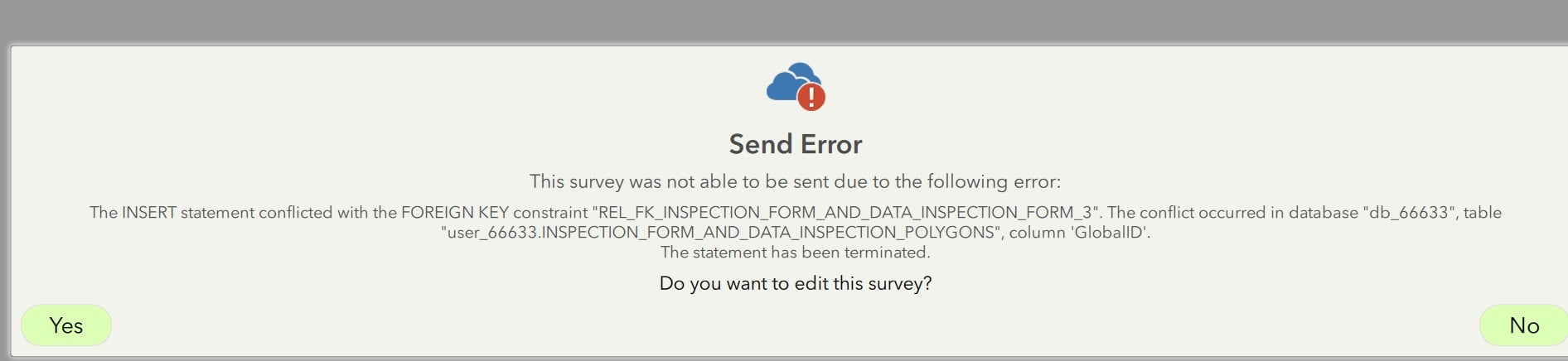

I still struggle with BUG-000117394 "The INSERT statement has conflicted with the FOREIGN KEY constraint" error (see attached screenshot).

I initially created the survey using Survey123 3.9, but I re-published using the latest version. Any ideas what I am doing wrong? One thing I am not entirely sure about is: I might have added the attribute index to the GlobalDs AFTER creating the relationship classes. would that matter at all?
