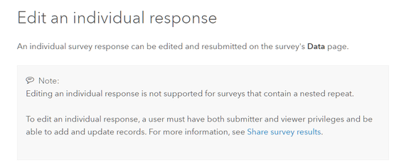

However, today when the user attempted the workflow he mentioned he couldn't edit records. I looked into it further and noticed this message:
Then I found this documentation from Esri, that does specify that editing functionalities are not supported for records with nested repeats.
Then I thought, "Ok, but maybe they can still edit in the data tab." I was able to make changes when clicking on a specific value in the table, and a colleague of mine tested it and it worked for her as well. However, it still did not work for the user who originally submitted the record (I assume this is because they are not an administrator type, and we want to keep it that way).
So....one question is just WHY is a nested repeat a limitation for this? Is there any plan for supporting this functionality in the future? Is there any type of workaround I could do for this so that the user can edit existing records in a browser interface?

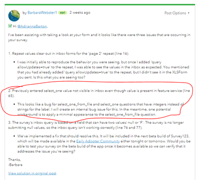

However, I'm still trying to work through some issues where data is not displaying despite having that expression in the parameters column. Do you know if there is some known limitation with select_one questions and the inbox? The data that is not displaying is the species name, which is selected from a drop down list.

I'm not sure what is causing this. Something ressembling your problem was considered a bug:
Solved: 3.14 - Fields with calculated relevancies are clea... - Esri Community
Could be a bug or there could be something wrong with how you wrote your question and choice list?
Katie_Clark
MVP Regular Contributor
Thank you so much for directing me to that other post, it definitely seems related! I used the workaround mentioned of moving my relevant expressions to the bind::esri:visible column, and it looks like that part is working now. 🙂
