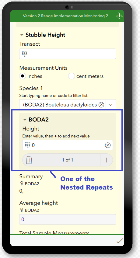

Backstory:  I am creating a workflow for collecting and editing riparian and range data.  My field users need to be able to update data they collect in the field.   An experience Builder app with a Survey widget looks like a great option; however, our form uses some nested repeats.
The users walk transects while repeatedly recording measurements which get averaged.
Right now users have the option of recording multiple transects on one form.  If I remove the repeats the users will need to collect 1 transect per survey, and they will need to fill in the administrative portion of the form again.
