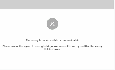

I tried to check out your example of in your Survey that said "Check it out here..." from above and it say's it does not exist or is not accessible:
Was this survey deleted?  If not, can you share it publicly so that I can see the <video> tag example.

My apologies - cleanups are necessary..., but sometimes they go awry.
I've updated the link in the post but FYI the URL is https://arcg.is/1byD5W0.
