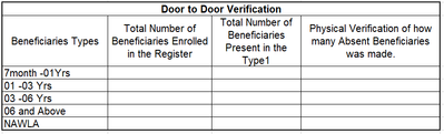

Hi Everyone,
Can you help me on how to or what is the best way to design the Question in the Survey 123 connect. Please refer the image. I want to design like a table.
I am using app version 3.17.54.

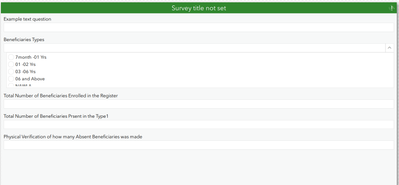

I believe what you are looking for is display the table in Survey form itself. I believe that is not possible at this moment (I will run some tests on it).
However, I can recommend using the available question types like "select_one", "text" or "integer" (depending on the need) to present these as question. You can also add restriction on input if that is needed. As sample may look like below:
I will share more details if I get those after tests. Hope it helps!

Hi Archit,
Thanks for the Quick Response.
But in that case we can't submit the survey for individual category.
I want to submit the survey with all the beneficiary categories.

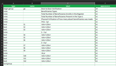

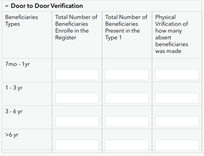

Something like this?
Don't forget to set "fixed-grid" on the Setting tab:
Here is more on grids/pages: https://community.esri.com/t5/arcgis-survey123-blog/survey123-tricks-of-the-trade-groups-grids-and/b...
Kristofer
Hi @abureaux ,
Thanks for the response.
We can do this, but the problem is Grid layouts are not supported in the web app.
Any other alternate / Idea, please let me know.
