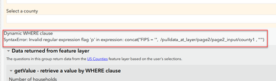

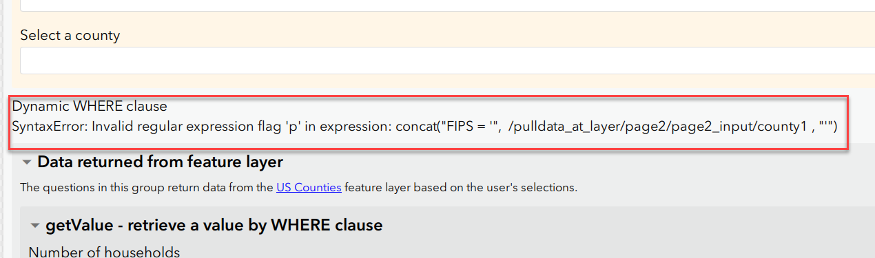

Creating a new Survey in connect, using that initial XLSform design, I noticed the following error when the form is using the concat function. As well as, nothing was returned when I selected the county (to be expected with the where clause concat function not working).

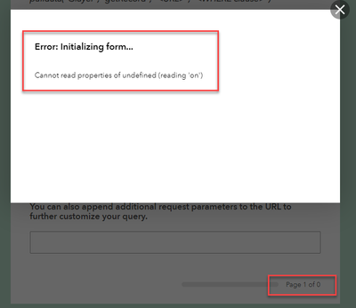

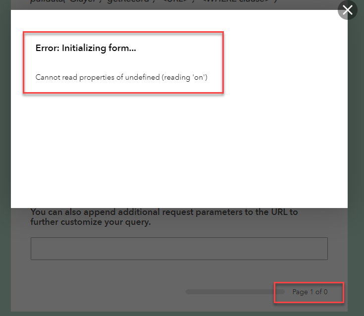

Web: get a undefined error and cannot even get to the second page.

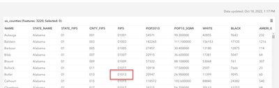

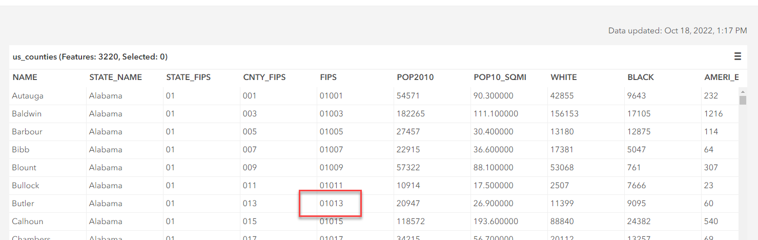

I then figured if the concat is causing the issue I would try and hardcode the where clause to see if I could get it to return anything. To do this I first went into the feature layer data and grabbed some FIPS data.

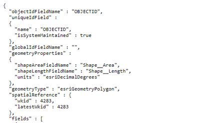

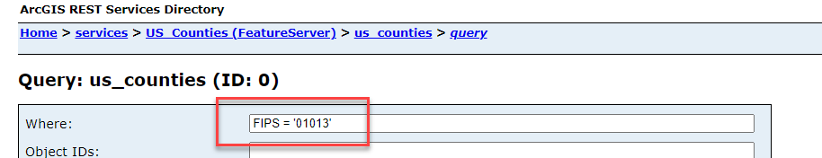

Taking this to the URL directly I tried to query the layer to make sure information was being returned
JSON was successfully returned

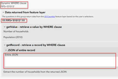

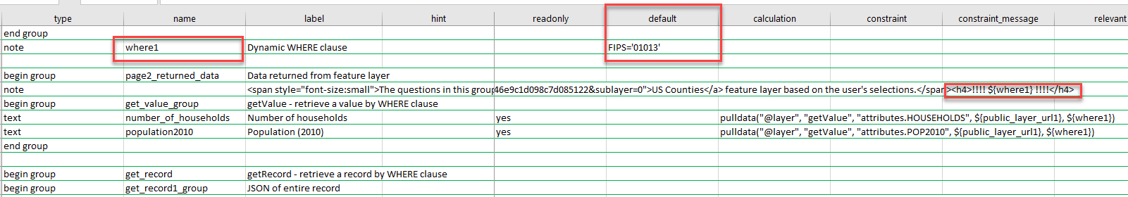

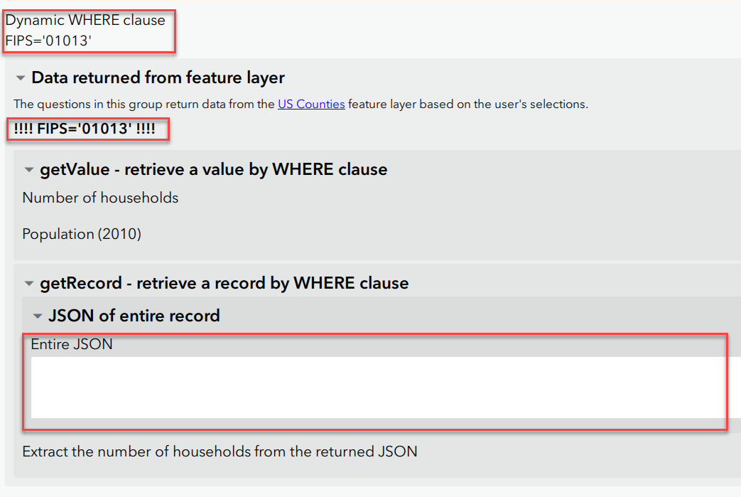

Thinking sweet its looking more like it might be concat function issue, I then went into the XLSform removed the calculation for "where1" and set the default to FIPS = '01013'. I also called ${where1} at the end of another note to ensure that it was passing the default as expected.
Doing this obviously got rid of the concat error, but still nothing is returned.
