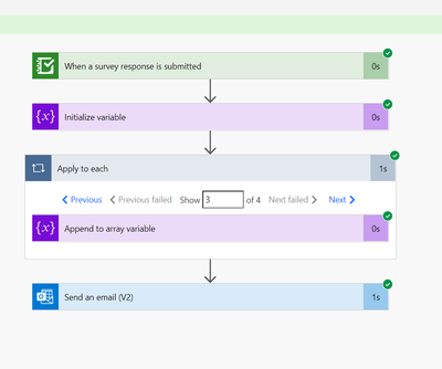

Thanks for the quick response! I tried to copy the steps that were in the blog post you sent me and I can see all the steps working and going through but when I look at the email there is no attachment with this information in it?
I peaked the code and the outputs which all seemed correct and I have the variable for policecheckin in my attachments section of the outlook module. Any idea why on the email there is no attachment?

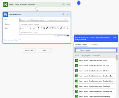

Hello @3CDCOrganizationalAccount
To access data that was submitted through a repeat in Power Automate in the Dynamic content there will be variables that start with "feature repeats" and is how you can populate attribute information that was submitted in a repeat.
Thank you,
Zach
